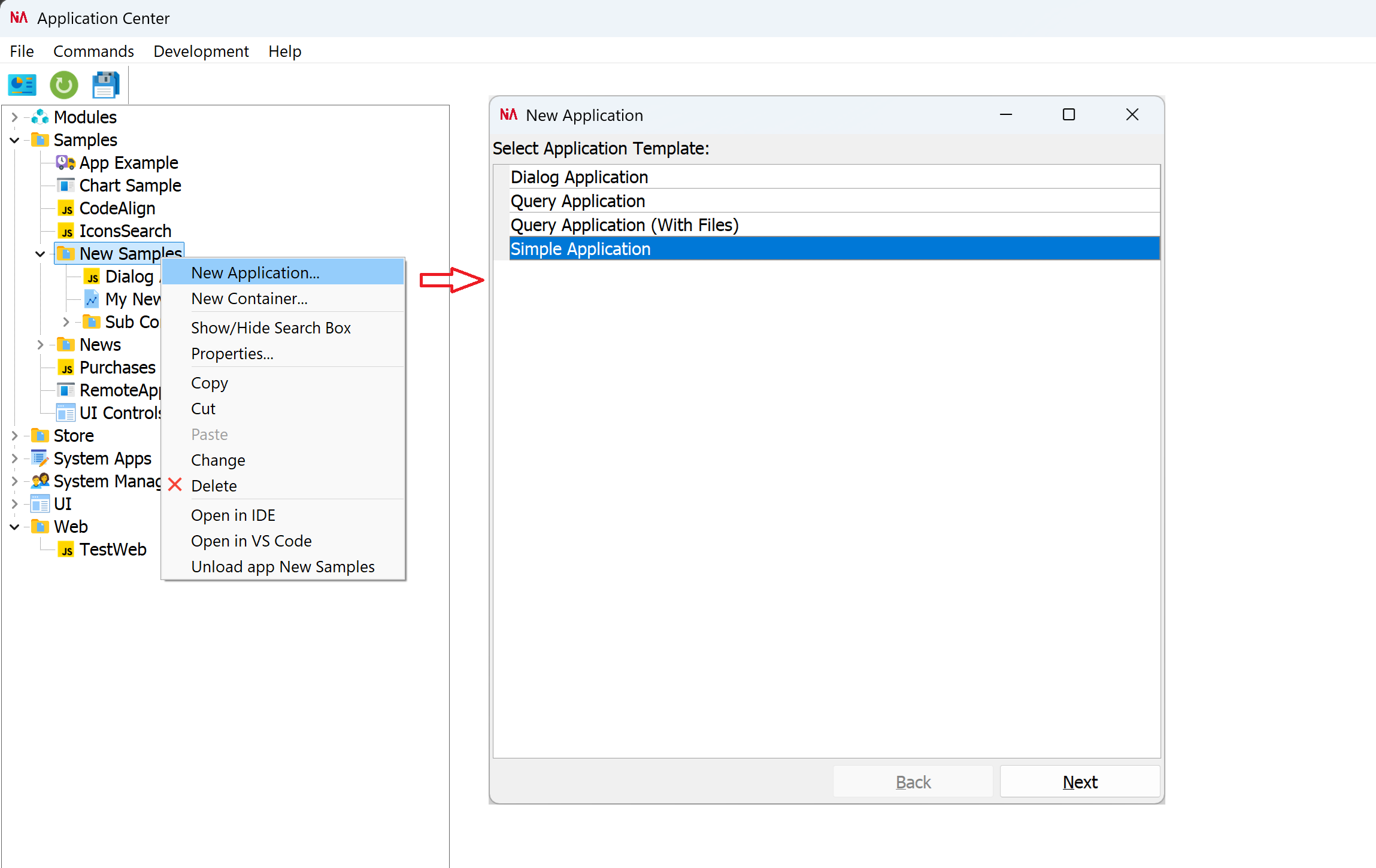

Launch New App Wizard
Select container (folder) where you want your app to be located. Then call command New Application... from the context menu like in the picture below.
In the first page of the New Application wizard select Simple Application template and press the Next button. Context Menu→New Application...
