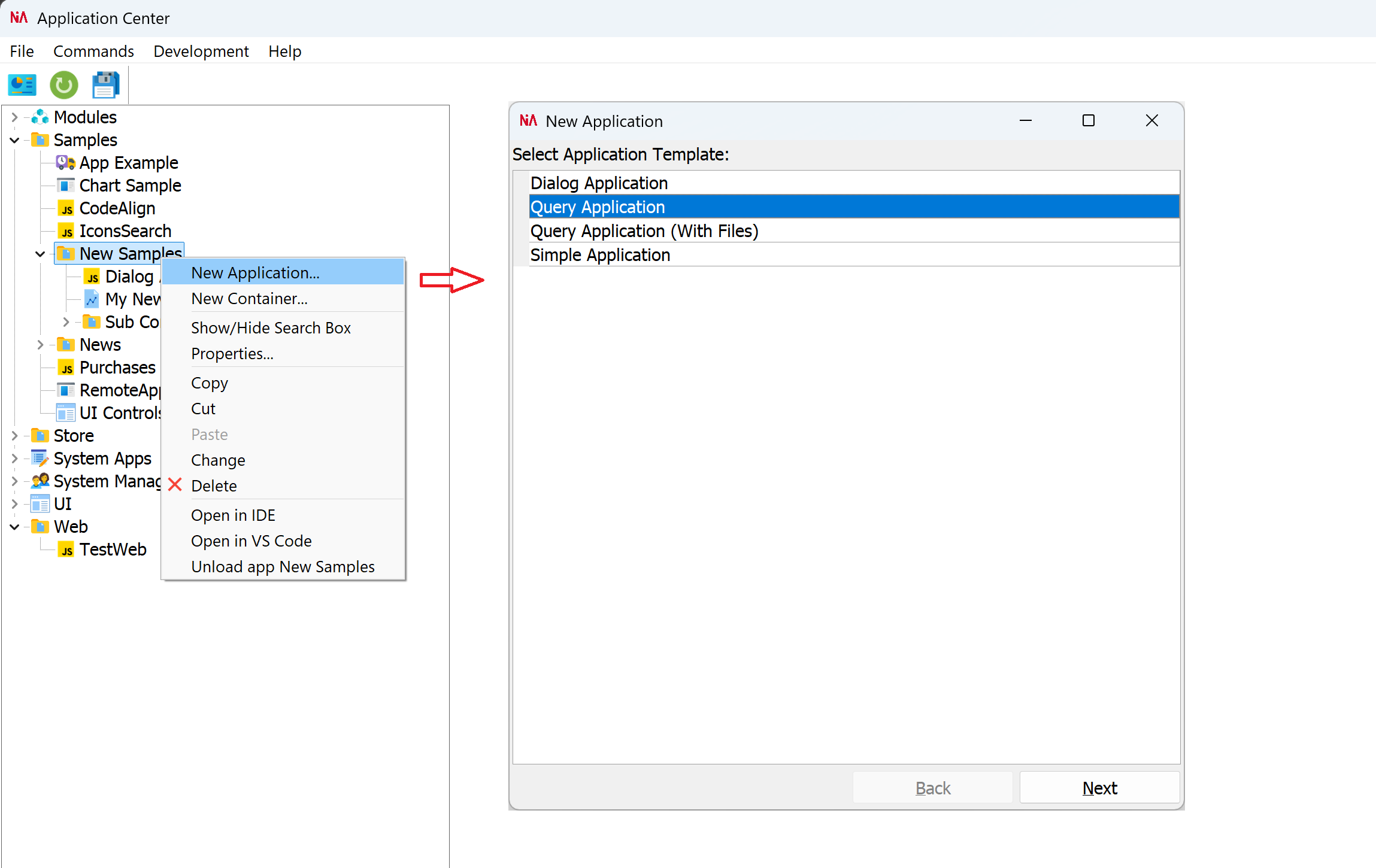

Select container (folder) where you want your app to be located. Then call command New Application... from the context menu like in the picture below.
In the first page of the New Application wizard select Query Application or Query Application (With Files) template and press the Next button. Query Application (With Files) is reserved for querying document classes, while Query Application is for querying data classes or when you are not interested in displaying document files. Context Menu→New Application...

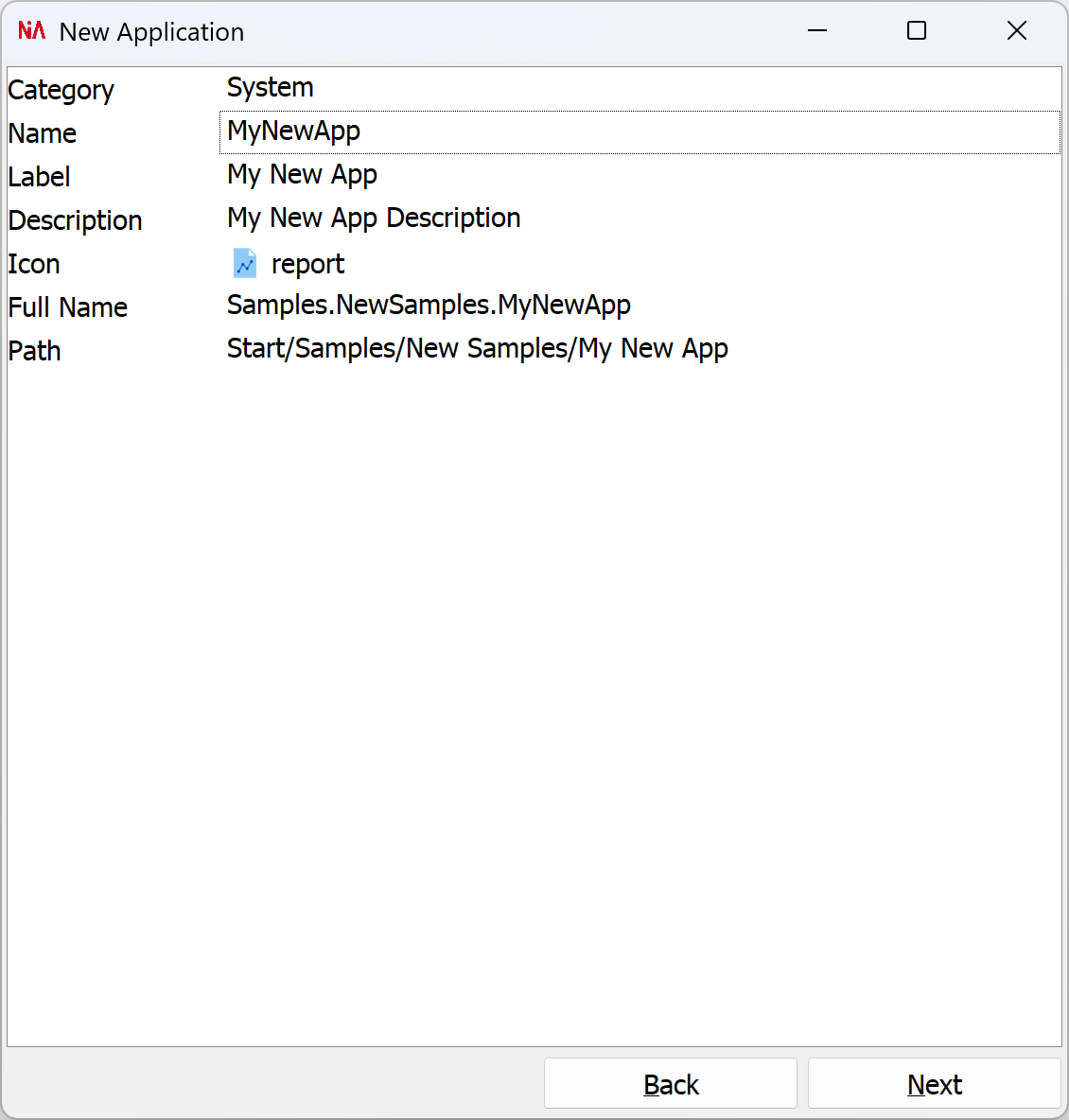

In the second page of the New Application wizard fill in the required fields like in the picture below and press the Next button. New Application->Second Page...
App Name must be an alphanumeric text without any spaces or special characters and must start with a letter. This name will be used in JavaScript code to identify application's class.
App Full Name is read only and is made of app's parent container name and this app name. This name will be used in JavaScript code to identify application's module.
You can see here how to use app name and full name to start an app from JavaScript code.

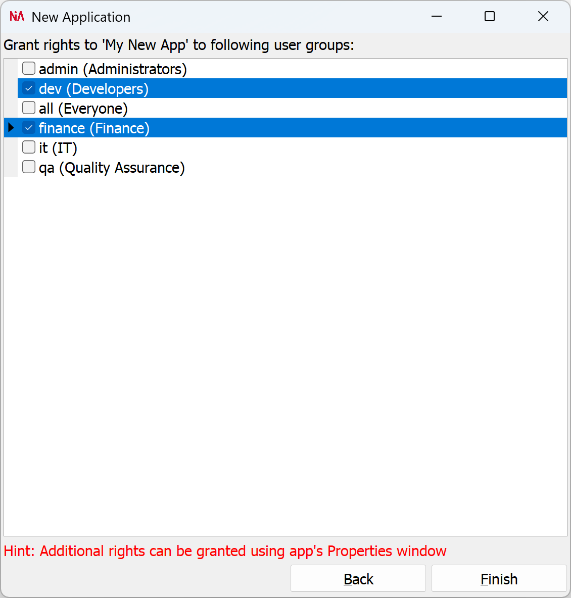

In the forth page of the New Application wizard select which user groups will have the 'execution' right on this app and press the Finish button. Application rights can be also later granted or revoked using app's Properites Window (command Properties... in the context menu in the first picture above).
New Application->Third Page...

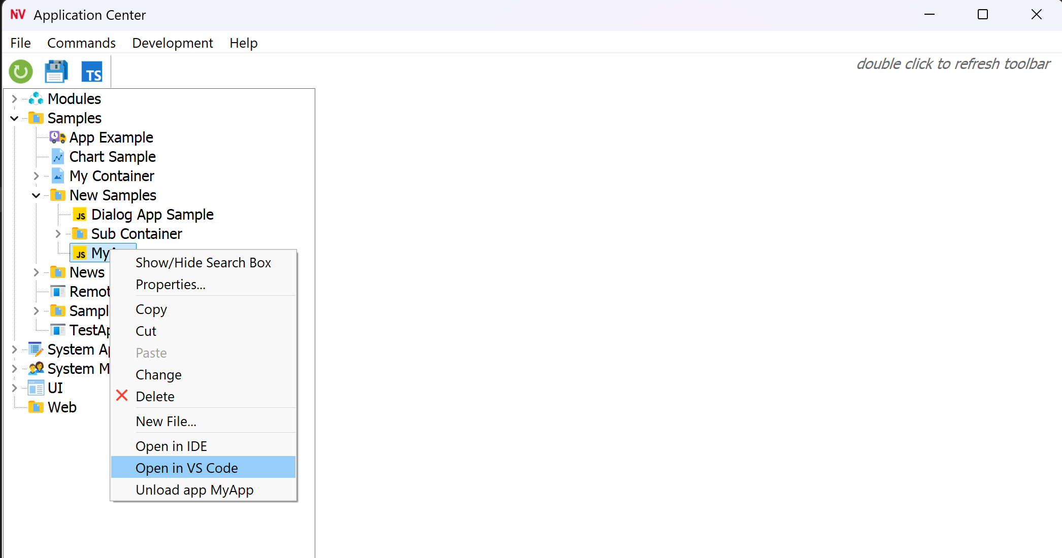

You can also use context menu commands Open in VS Code or Open in IDE, like in the picture below.
Open in VS Code will open Visual Studio Code or Codium, wich is always the best option for changing the code in NodeActa. VS Code has a sophisticated code editor with auto-complete which simplifies code writing, plus much better and faster debugger.
Open in IDE will open Application Center in Integrated Development Environment (IDE) mode, where you will not be able to execute your apps, but to edit your apps' code instead. We strongly recomend using VS Code instead of build-in IDE. Build-in IDE is good only for small changes when you don't want or you can't install additional software (VS Code or Codium).

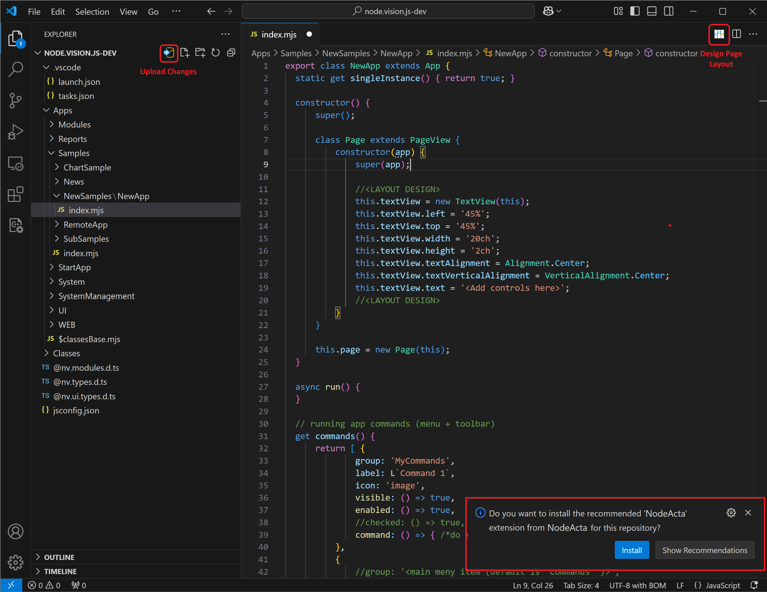

In VS Code, you can modify existing application .js files, create new ones, or delete unwanted. All the changes you make in VS Code are local and only you are affected by them on your local PC. If you want other users to see your changes, you will have to uppload them to the server. To upload the changes run the command (Ctrl+Shift+P) NodeActa Upload Changes or press Upload Changes button like in the picture below. Alternatively, you could call Commands→Save All from the main menu in the Application Center. Also, every time you close Application Center, you will be asked to uppload changed code (of course, if you are logged in as a developer). Edit New Application in VS Code
Standard apps always have index.mjs file. They can also have any number of other files next to index.mjs or in sub-folders. WEB apps are an exception, as they can have index.html instead.
