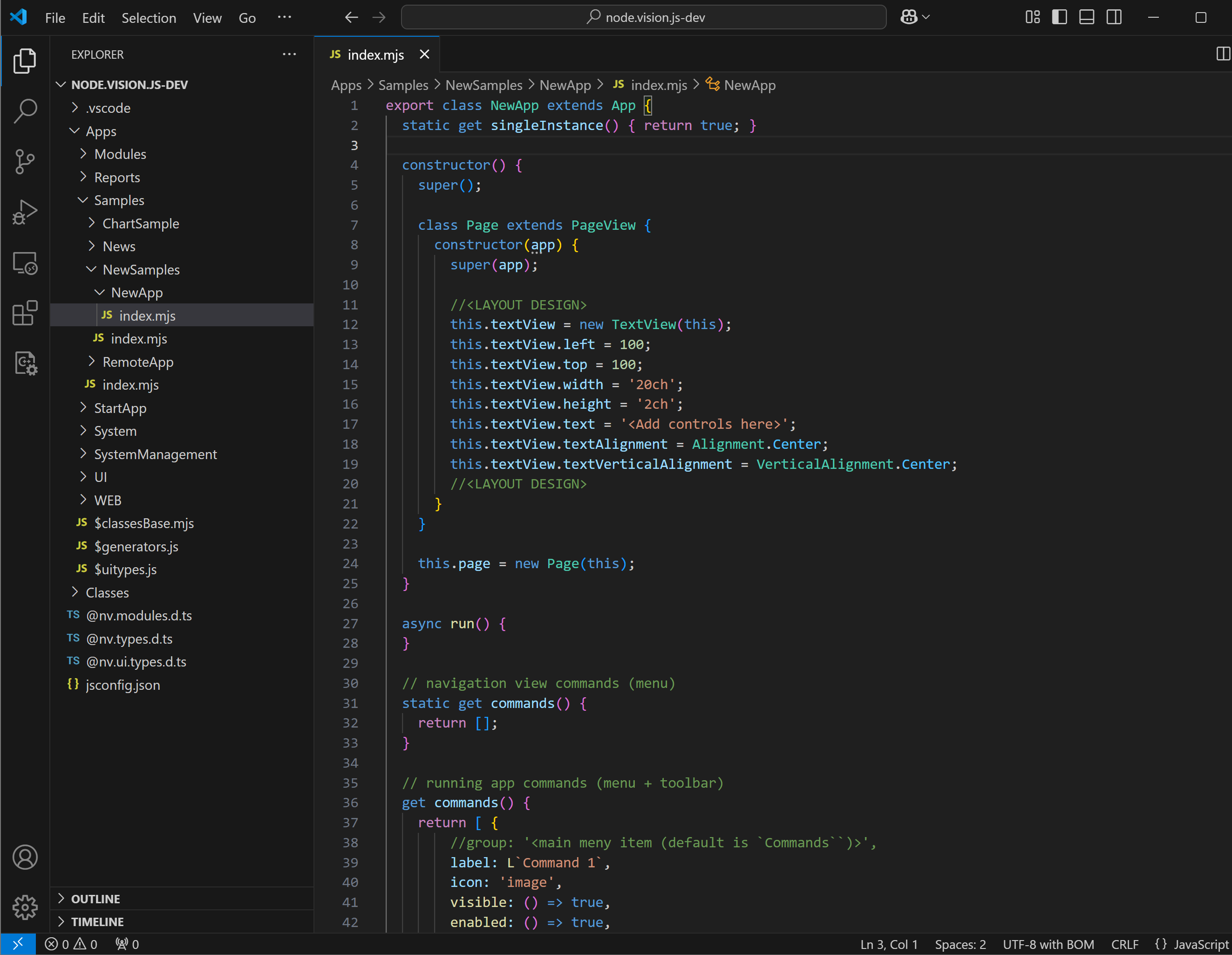

In VS Code, you can modify existing application .js files, create new ones, or delete unwanted. All the changes you make in VS Code are local and only you are affected by them on your local PC. If you want other users to see your changes, you will have to uppload them to the server. To upload the changes run the command (Ctrl+Shift+P) NodeActa Upload Changes or press Upload Changes button like in the picture below. Alternatively, you could call Commands→Save All from the main menu in the Application Center. Also, every time you close Application Center, you will be asked to uppload changed code (of course, if you are logged in as a developer). Edit New Application in VS Code

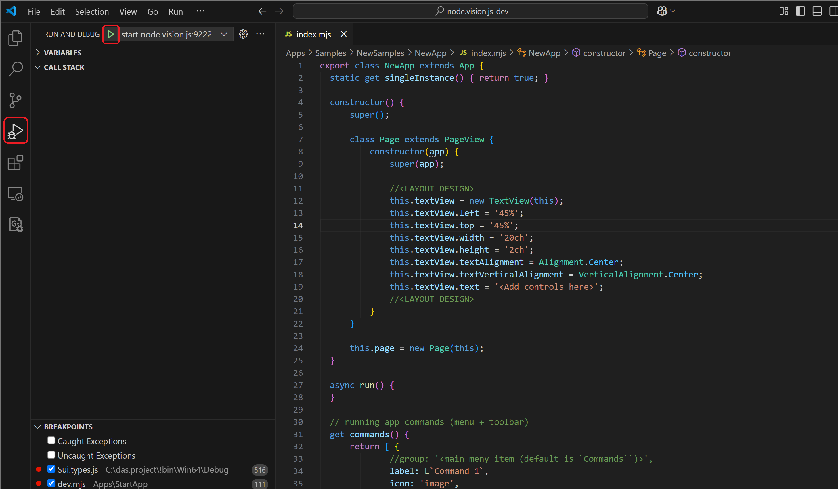

You can start debugging your code by pressing F5 in VS Code, or by switching to the Debugger tab and pressing the Debug button like in the picture below.
This will start Application Center and ask you to login. It is important to login within 15 seconds, od debugger will not be active. Start Debugger in VS Code

If you select Simple Application template when creating your app, the system will create the basic structure of a single page app like in the picture below.
Edit code in VS Code
Generated code includes the NewApp class definition, which must inherit from either the base App class or another application class. For instance, you could create a NewAppEx app that extends NewApp and overrides only the methods you wish to modify.
Within NewApp class constructor, a single Page with a single TextView is defined.
The TextView declaration is enclosed within //<LAYOUT DESIGN> markers. These markers indicate page layout boundaries and are utilized by the Page Layout Designer. Removing them will prevent you from designing the page layout using the Designer. Additionally, avoid making manual changes to this code, as it will be overwritten by the Designer.
In NodeActa, each application includes a run() method. Page layout should be designed within the app's constructor, while data initialization should be handled inside the run() method. Keep in mind that constructors cannot call and await asynchronous methods, whereas the run() method has no such restriction. See Launch App From Code.

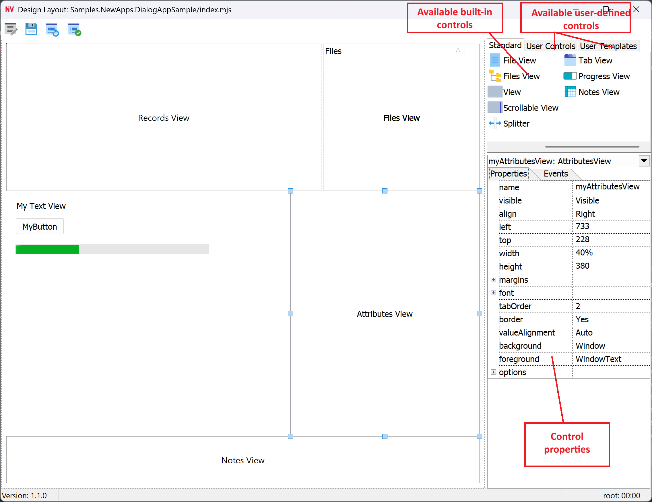

You can create a page or dialog layout by coding it manually, but in most cases, using the Page Layout Designer, as shown in the image below, is much easier.
Design Page Layout

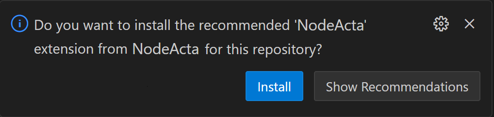

Page Layout Designer is available in Application Center in IDE mode. Each file opened in Application Center in IDE mode has option to edit either the Code or to Design the page. Alternatively, you can launch Page Layout Designer directly in Visual Studio Code by using the command (Ctrl+Shift+P) NodeActa Design Page or by pressig Design Page Layout button (like in the picture in Write Your Code section). If this command is not available, NodeActa extension is not installed. When you open VS Code from the Application Center, you will be offered to install this extension, make sure you press Install button (like in the picture below). instal vsix
